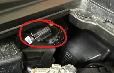

So I played around with my 2011 FX50 and can report some updates. With the car in the stock wiring configuration, upon starting the car I would see 14.0v at the OBD2 port, but after about 10 seconds it would drop down to 13.0v and stay there for about 8-10 minutes of driving, after which time it would kick up the voltage to 14.0v. Note, that I only drove 2-3 miles in those 8-10 minutes, so it seems to be more time-dependent than mileage-dependent before it decides to fully charge things. Because this is a surefire way to kill a battery, I unplugged the wire harness thing at the negative terminal. Now the car is steady at 14.0v no matter what I do! The only downside is that this does trigger two silent/ghost error codes about the intelligent charging system, but they don't trigger the CEL. You would only know they're there if you run a scan for codes.

Do you happen to have a pic of the wire harness thing? I don't want to unplug something else lol. Though this dead battery thing hasn't happen to me yet (newer battery), I can feel that the car is struggling to start in the mornings now that it is winter here.
