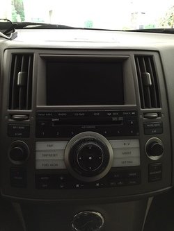

Can I get this to produce vid support like the netflix pic? I have no navi. Audio over Bluetooth?

Does it also have xm?
Dope!
