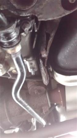

I had to get under the car to replace the rear camber and toe adjusted bolts. You have to remove the center-mount bolts for clearance on those. You also have to remove a couple plastic splash panels to to get to the ASB bolts. While removing the splash panel bolts, they pretty much all busted off (the bottom side of the entire car is a rusted mess). But worse, removing the rear-most 10mm bolts, a very large portion of a crossmember that sits between the gas tank and the rear suspension completely broke away -- the bottom side of that whole crossmember is rusted out, very crumbly and easy to break apart. I'm not even sure which part it is from a diagram, but I'm assuming it would be quite a PITA to replace. Anyone have experience with this kind of stuff on an FX35 (2003)? Nightmare...

Here are some pictures...as I said, it's between the rear suspension/axle and gas tank. I'm thinking it's probably there for protection more than anything. Doesn't seem horribly important structurally. You tell me :)

honestly where was this car stored? In the f*cking ocean? that's just crazy, i have never seen that before on a car that's not 30+ years old
Wow that's insane!! But there's an easy explanation for this..where is this car stored? Is it anywhere near grass?
Nevermind, he's in Utah and they get tons of snow. With that being said, the roads must get salted pretty heavily. That's why its this way. Was the car ever rust proofed? If not...you better start now or you'll be replacing sub assemblies...like that one that's eaten already.
Nissan/Infiniti is pretty known for rusting fast, they don't secure the undercarriage all that well.

Ah, it hit me now, I remember this part..mine was just starting to rust on some of the edges. This is a multi use piece that protects the fuel tank, adds some strength to the floor and I think there were other uses for it. I wish they had this part undercoated from factory, would at least keep it from rusting to that degree.
I would still try to rust proof it so the rust doesn't continue into the flooring.
Ok -- yeah, it doesn't seem overly critical -- I don't know what rust proofing will do at this point. But I'll try to get under there again and chip away until it's solid. It looks like a real PITA to replace. It looks like it just gets the brunt of anything flying up from the road toward the back -- should've used aluminum. Also, much like you said -- it has some kinda 'rough' edges, corners, etc, for stuff to really gather up. It curves up over the exhaust and driveshaft, then comes back down and connects to each side of the car. I just have to hope, assuming I do replace it at some point, that the bolts and other parts it mounts to aren't rotting away.
Sometimes I question the things Infiniti does, at least they could coat it with something to prevent rusting. I would chip away as much as you can without killing yourself, watch your eyes, rusted debris is pretty bad, and wear a mask, it does get airborn too. Then just spray it with rustproofing oil, it will stop it and prevent it from continuing. That way you can buy some time. The oil will wash out slowly, but its better than nothing. When I bought my 2nd gen, that's the first thing I did was climb under the car and check the undercarriage.. The differential and exhaust is the only two things rusting on my car..and its leaving rust spots on my garage floor..can't wait to get an Invidia exhaust and I'll have to paint the differential
