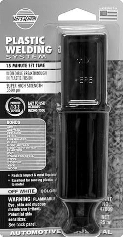

Dealer item. You could do a temporary repair with some two part plastic weld--
Yes thats definitely something I could do in the mean time to prevent the coolant from leaking, but I do want to replace it to be on the safe side. I could get an aftermarket, but ours are mounted. I want to make sure it stays put and doesn't slide around. BTW, thanks to you to everyone who gave their input.
