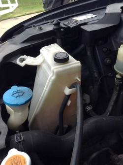

So, I get back home from taking my parents to the airport, then I open my hood to add oil.. and I see the coolant overflow tank is literally full with some coolant around the top.
What on Earth..? How..? and why did this happen? lol
