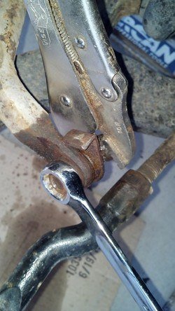

I ordered front endlinks for my fx35 (Moog from Amazon). They were $13 each vs. $29.99 from O'Reilly (and they didn't have them within 2 days). After pulling off the wheels I re- checked the sound I heard from before. Even more obvious the end links were shot. No sound above the top mount point. Pass side nuts were on pretty tight (rust), but I used pb blaster, my crappy air ratchet to shake it up, and a breaker to loosen. Driver side...lower nut was on REALLY tight. I barely got it turned until the stopper 'set' and then had to use a small jack to get it started. It bent the stopper ear itstead of loosening the nut, so I turned it back and rebent. Then it popped off the keyed section and just spun when turning. Ugh. So, I pulled the upper nut, then popped the arm off the bottom (just pulled it off the joint). Then took a large vise grip, set it against the half shaft and FINALLY got the first real 'squeak' as it loosened the nut. Took another several 1/8 turns in an odd spot with a large breaker, but I did finally get it off.
Clunk completely gone. Solved. Woohoo! I'll post a picture of what I had to do when I have posting permissions.
