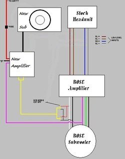

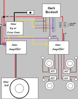

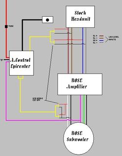

Felt like doing a diagram to help other members. Colors are correct for the 1st Gen.
Subwoofer install:
Epicenter Installed on stock BOSE subwoofer:
BOSE Delete

Thanks, this was a great help. Just got done adding in my Hertz high energy 10", I used an LOC off the factory sub signal and left the Bose sub unplugged. Sounds great! I need a better front stage to match my sub now :)
Hi, looking to add a sub to the stock system, but I have a question on the first subwoofer install diagram...you tapped into the stock system after the stock amplifier with RCA, but wouldn't you need to do this before hand to get the signal at line level and not amplified? Wouldn't you need a line converter? Thanks in advance.
Visceral,
Good question, and a LLC is not needed. The first stock BOSE amp takes the 4 inputs (really just 2, one pos and neg for each side) from the stock HU and passes them through the amp to the second BOSE sub amp. The line we are tapping is not amplified and is a passed through line level input. The Amplification of that line takes place inside the subwoofer "enclosure" where the second amp is located.
Bose passed through the signal into the new white and black wires going into the sub amp from the original amp.

I tapped the signal wires (using one side of the RCA pair) that go into the stock Bose sub amp (as in diagram # 1) but my output from my aftermarket sub/amp set up is very low. I even boosted the amp gain and the bass level output and my music output from my aftermarket sub is barely louder than the stock Bose sub.
I'm using a JL 500/1 & a 12w6 sub.
I am not sure why my sub output is so low.....I have proper voltage into the amp (checked with a multimeter) and I have a turn on trigger with a 12+ Volt input into the amp.
