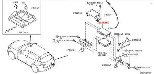

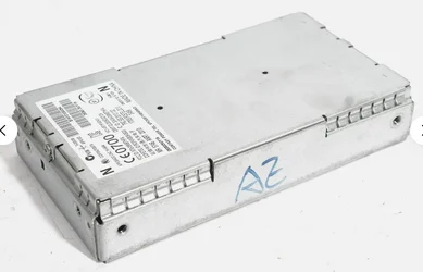

From what I looked up, it's part number: 28383-3WY1A
Here's a reference on what to look for:
