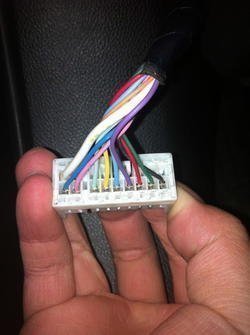

Guys, I have a problem here with mine 2011 FX. I tried to remove the 2nd purple wire from left, I think this is the correct one right? When I putting everything back, it doesn't work on mine NAV and DVD. It's so wired....:( Please help, let me know if I did anything wrong.
Mine did not work....Guys..plz help. There is ppl who did it with 2011 model right? Does Canadian FX has different wiring then US ones? So confused now....
Doesnt look like the right harness. Make sure u got the right one. It's confirmed on the 2012 so ur 2011 should work
