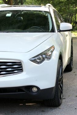

So I reviewed the post. How do you like the Nexen's FxMonkey? Any regrets about the wheels?
Any particular reason to do the 285/35 vs 285/40's I was thinking the 40's fill the fender a tad more at stock height, give a little more wall for wheel protection.
In some of the pictures they look flush. In others it looks like they stick out some maybe its just the angle of the picture?

I have no regrets about the wheels. They weigh very little and they look amazing on the fx. and for the price i couldnt be happier about the desicion i made. the nexens are great so far but moving from a 50 to a 35 tire made a big difference in ride quality. i wouldve gone 285/40 if i wasnt lowering and the 40s look too beefy imo. at stock height the wheels in the back are exactly flush and in the front they poke out a tad bit. its hard to even tell at stock height

Yeah I doubt I will lower it I want to be as flush as possible. Maybe I should go with the 22 x 9 with 265/40R22 tires like Meduza. I just wanted the deep concave at 10.5 but want it to be flush all around
See Meduza's looks real good flush like they where made to be on the car from factory looks real good just wish it was the deep concave, bummer!

i mean you can do the 10.5 at a higher offset. mine is a 32 offset and you could go 40 or even 45 if you want

I checked out your garage your setup looks great very flush! is the last picture with the 22's with or without the H&R springs?
