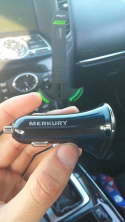

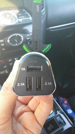

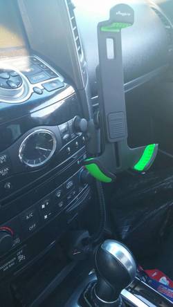

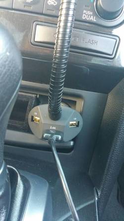

The last 2 pics are of my phone mount with USB base chargers that I use to charge my phone and two other devices.

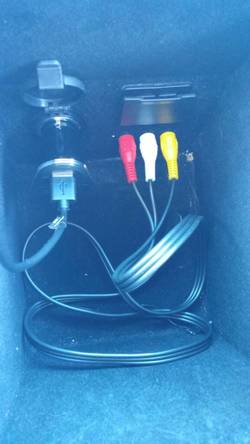

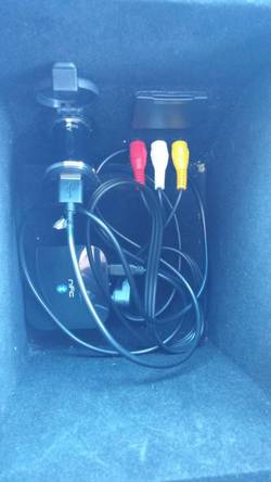

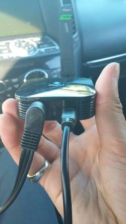

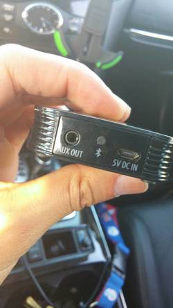

I just figured out an awesome and simple way to stream music via bluetooth onto the FX35 using the RCA jacks in the center console.
All you need is this bluetooth receiver and a
12V charger to usb in the console to power up the Bluetooth receiver and of course, a smartphone with bluetooth capabilities.
Plug all components into their respective places, connect your phone to the receiver via Bluetooth, set your radio to AUX and stream whatever sounds come out of your phone, whether it be pandora, spotify, youtube, or music from your phone's library!
I plan on posting pics or adding a video tomorrow on all this. The sound is crystal clear and there is no static or interference.
My LG G3 android device was simultaneously connected to the car's bluetooth while I was connected to the receiver and while playing music. I placed a call and the music stopped playing and went straight to placing the call. The phone rang, the other party picked up the phone, we had a conversation and then we ended the call. I was hoping the music would return to playing where it left off, but unfortunately it didn't. I had to press play on my phone and also had to reconnect to the receiver, but that's only a touch of two buttons. So no big deal!

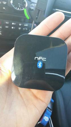

So it looks like i can't edit my original post. I tried editing this post because I placed an order for the linked $20 bluetooth receiver only to find that it wouldn't automatically connect to your phone when you get in your car, like the HomeSpot one I have pictured in the post above this one.
This is the link for the HomeSpot i have pictured above. http://www.amazon.com/HomeSpot-NFC-...462309577&sr=8-11&keywords=bluetooth+receiver
This one will automatically connect to your phone without having to press a button like the other one.
