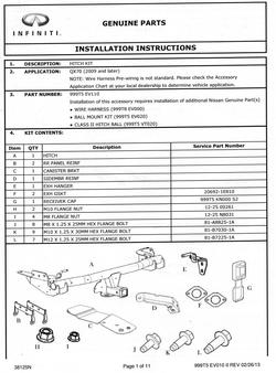

2nd Gen OEM hitch (Part No 999T5-EV110):

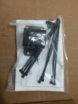

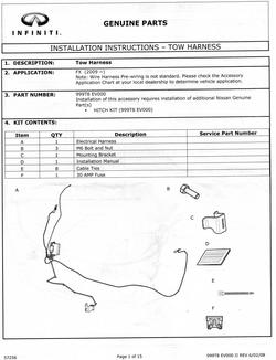

2nd Gen OEM harness (999T8-EV000):

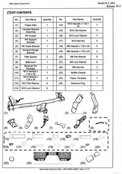

1st Gen OEM Hitch Part No 999T5-EP000:
The 1st and 2nd gen hitches are very identical to design, but likely not interchangeable.

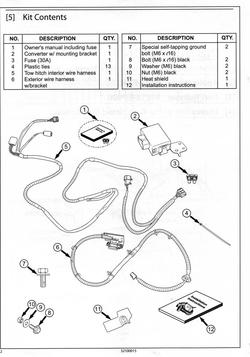

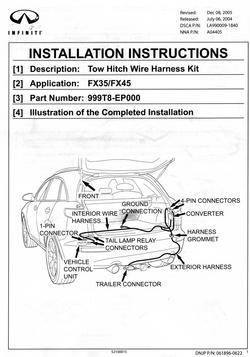

OEM 1st Gen Harness (Part No 999T8-EP000):
To install this you have to take apart the trim surrounding the inside of your spare tire area. Very easy to do, no cutting or modification required. Its a plug and play design. There's an existing hole you feed the wire down through to bolt it to the OEM hitch.
