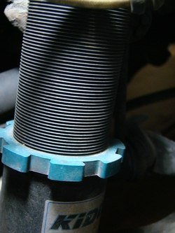

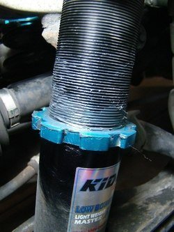

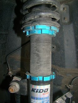

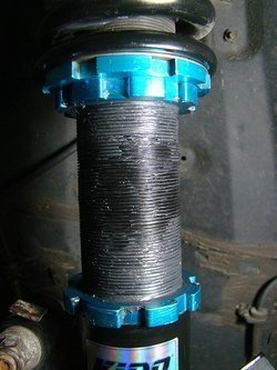

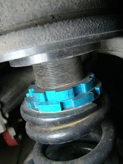

Well, I swap out of my 24s into my 20s winter setup. While at it, I also did some PM to the coilovers. I use a tooth brush, clean off the road dirt, and rub a liberal coat of grease round the thread and ring in hoping to prevent the winter salt corrosion and seize it if I ever need to adjust the height in the future.

Andy, I highly recommend this product called LPS3 for protecting your coilovers. http://www.lpslabs.com/product_pg/corrosion_pg/LPS3.html.
We used it at the Nuclear complex I worked at for protecting some parts for long time storage. I also have used it around home on parts. I also recommended it to a few friends on another site for their coilovers and they were very satisfied with the results.t.
