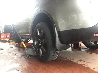

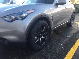

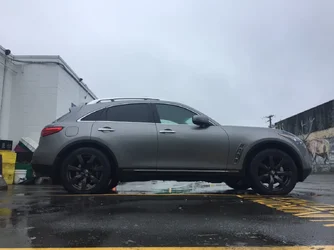

So just to confirm, the staggered set up of the GT-R wheels works with no issues? The 10.5" rear wheels with +25mm offset works with absolutely no issues? No rubbing or any problems with the hub or suspension? I am wanting this as my winter set up on me 2017 QX70 limited. Need to be 100% that the 295 tire on the back with 10.5" +25mm rim is working without issues? Anybody, feel free to chime in. Would a 265, 275, or even 285 tire work in the rear as well? Any modifications needed whatsoever for the GT-R staggered rims set up?
GTRs for winters? That’s a first.
Saw your other thread. 295s are the way to go. Stock gtr comes with 285s but smaller profile tire. I think a 35. No reason to go there on an FX. Some like 45s, and that looks ok on stock height but to me feels like too much tire sidewall. I’m a fan of 40s with a drop.
Are your tires 295/40s all around on a squared or staggered setup? I currently have Niche 20x10 rims with 275/45s all around on my 09 FX35 RWD but just purchased a set of staggered 2010 dark hyper GTR rims. I would honestly like more of the rim to show and agree with your philosophy. I was researching tire sizes currently. From the looks of it, it looks visually odd to have the same sidewall all around on a staggered setup?
