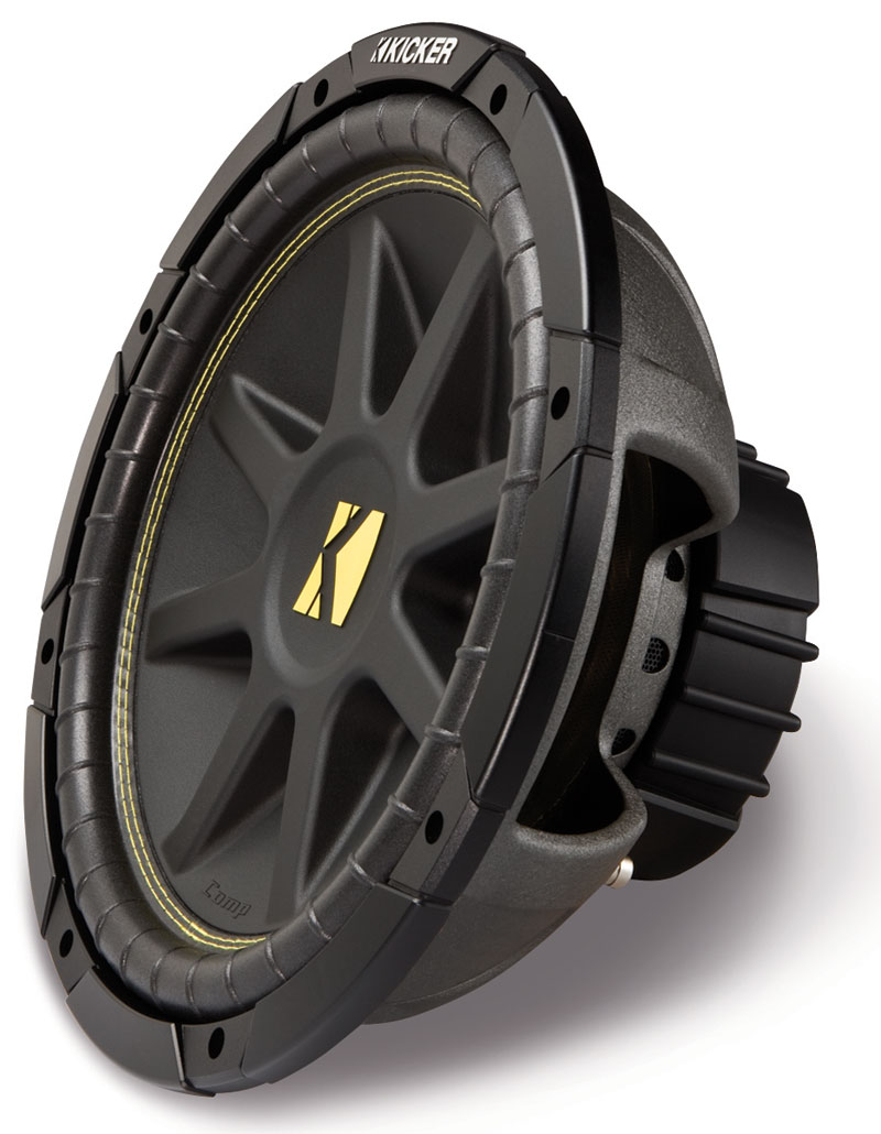

i am thinking about adding 1 10" sub and amp. This is what i am looking at...
Any good cheap sub options that you have used??
Kicker C1 12" Subwoofer Single 4 Ohm 150 Watts [10C124]
List Price: $129.95 Price: $59.75
