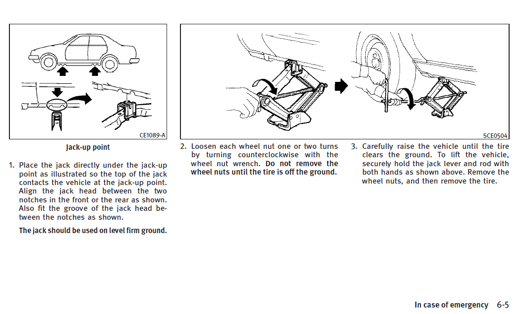

I don't want to mess up the pinch weld on this car. Any suggestions on where to jack up the car? I'm looking to jack up the car from the front so I can install my fumoto valve.
I've never lifted my car at the lower control arm. I'm not sure where that is. I ended up buying 2 sets up ramps to try them out. First one sucked cuz it kept sliding but the second one did the trick.
