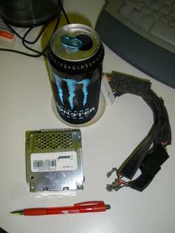

This is not really scientific but here is how I tested mine. I had the stereo playing a bass heavy song. I then physically slapped my sub and the bass went down/away, I then hit it again and it came back. What you described with your bass coming and going when hitting bumps in the road is exactly what I was experienceing, so I simulated it with my own test. I opened up my enclosure and checked all connections and everything was great, so I came to the conclusion that the amp was bad.
I snapped a pic of my old amp so you can see how tiny the thing is.
