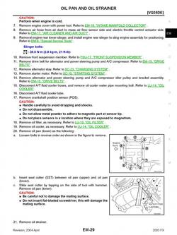

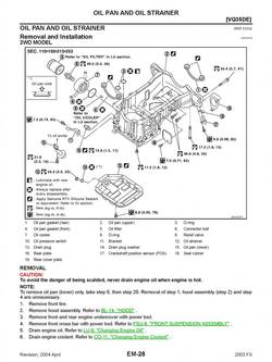

I would definitely drop the oil pan for the peace of mind! Here a couple pages from the FSM.
