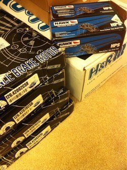

Recommended new rotors and pads for FX50S. Help!
