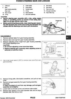

From where the leak was described it looks to be the Rack oil Seal Item #13.
If thats the case this seal would have to be done in a shop. It's pretty involved and specialty tools are required.
