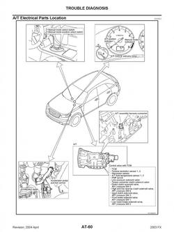

Here is a pic of the harness that you can take a quick peek at. A bad connection can cause that code too.

Yes we have been talking. I'm not sure how much this VB should be. I cant find any info on the weight of the VB to see how much shipping would cost. Im on the east coast in Philly, and taking a trip up there is not possible at the time. Hey Andy, looking at your schematic above, I see that the TCM houses the ATF PRESSURE SWITCH 1. Can they be replaced by taking them off the VB?? or are they a permanent part of the VB??
