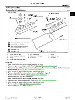

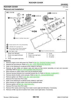

I'm not sure there's channels in the cover itself, when I took mine off, there's nothing more than just seals and the cover. The two PCV valves are detachable on the V8 or one on the V6 model. They unscrew from the valve cover itself.

I spent some time today at my local shop (not dealership). My guys there build lots of track cars. Keanan showed me the inside of a similar valve cover, there is a plate with small holes that feed into a tube that leads to the pvc outlet and he said its the same in the VQ. I could try seafoam but he suggested an oil replacement product that has a lot of detergents in it. Theres just no way to get seafoam all the way through the tube from the outside. You are right about the dealer and replacing the covers, they dont want to fiddle with cleaning something, then if it doesnt work it was all a waste. Rather get paid, swap it out completely and move to the next thing. You are also right about them no knowing, especially service managers... i've had to correct mine on several issues and thats why I took it to ALL Aspects today.
