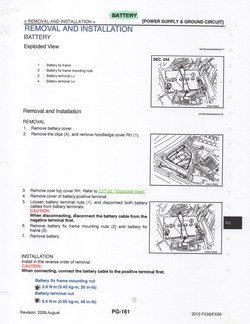

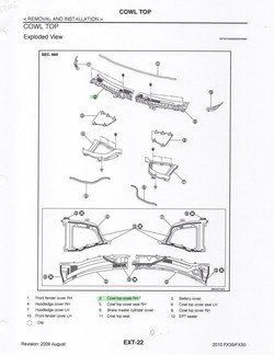

Here are the OEM instructions for Battery Removal and Installation on the 2nd Gen
