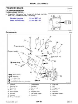

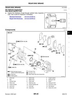

Hey everyone - Couple questions for u guys. Wifes 05FX is squeaking after brake job, so i think i am going to apply some brake quiet on the back of the pads and i heard u can sand the pads and rotors. Does that mean just take some 220 sand paper and scuff up the the pads and rotors ? Any certain technique for the rotors? Also want to grease where the pad sits in the caliper clips and slide pins. Can i use any old brake grease?
Lastly, done any have the torque specs for a front/back brake job? Thanks [emoji3]

yep they were bedded by sears. Wife got the brake job from them awhile back and I am just getting around to what I need to do. Anyone have the torque specs and what I mentioned above? Cheers
