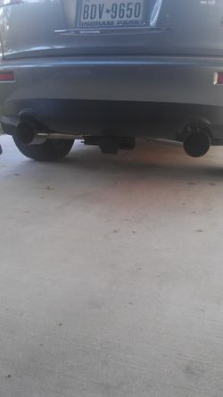

My Custom Exhaust...

I wish there was another FX in town with some sort of exhaust could I could get an IN PERSON idea of the differences - I mean, things sound different over the web always - I am just dissapointed. I will be removing this system later this week and going back to stock - anyone interested just shoot me a PM. I don't feel like messing around with different ways to reduce sound or anything with this vehicle, I made a silly jump decision on this exhaust and I regret it, but all is well because I have my full OEM still - so I rest easy.
Okay guys, I will be placing a For Sale ad coming Saturday - The exhaust is coming off Friday. I will get a few different videos as well so you guys can get a better idea of the volume. If I decide to do another exhaust it will likely be Axle back only and be a low key magna-flow or similar. If I could afford the Invidia right now I would jump on that! But I would much rather go lower and get some nice wheels first.
