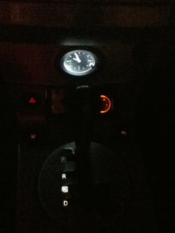

led swap in my clock.
Looking good, I see you did the shifter panel as well. But you don't mind that the rest of the dash is a mix of orange and white then?
IMG_0159.jpg[img]
I have been wanting to do that for a while.. If I can figure out a way to light it up without hot spot which one area is brighter than the other. very annoying.
I do mind the mix of colors but oloking at it like that will motivate me to do the rest. The clock was a little tricky theres a little oem craddle you have to take out the bulb from the re-fit it. Also when you put the bulbs back in make sure you try them both way because you cant really tell what side is - and what side is +.
The shifter im not that happy about. But single led's shoot one way. Old bulbs gave you light from every direction the leds only shoot up. I might drill another hole and wire another one in there.
