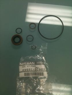

Leaking Power Steering Pump
very easy diy, took me less than 20 mins to take off pump with pulley and put new pump with pulley on.
There is no hidden bolts. Take off serpetine belt, 2 long bolts 12 mm i think on the pump threw the pulley holes. Then take off the top bolt on the pump. 21mm if i recall on the pressure hose line right on top of the pulley. Take the clamp off the hose that connects from ps reservoir to the pump. Then pull out your pump. THats it. Only thing to worry is not to break the washer on the high pressure line when u put it back on
