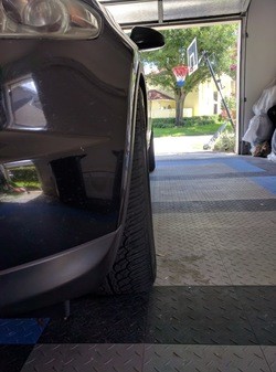

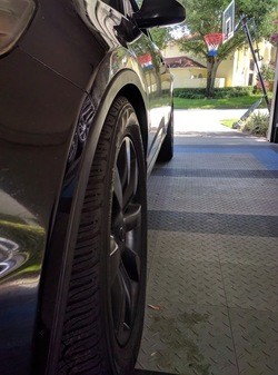

Just installed BC Coilovers and Spacers.
reissgrant
- Just installed BC coilovers and H&R spacers (30mm front and 25mm rear). Running 9 clicks from hard in front, and all the way hard in the rear. You guys who changed the springs to different rates, where did you get your springs from? Not sure I am happy with these 8kg fronts and 12kg rears.

Unless you slam it, it's not required. I think you look OK at this height
