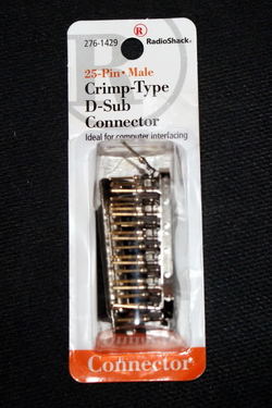

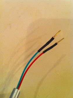

So i tried this today and was not succcessfull.
So what did you put on the end of your invisicord under the heatshrink?
I tried just soldering the ends of the wire but did not work
thanks
Randy
"Handy Andy", la_fx35 used old phone cords for our power cords too. He should chime in and clarify what you can do sometime soon.
:tup: Pman, I also use the D-sub connectors like you pointed out above. I strip about half inch of the sheeting off each lead of the exposed telephone cord, crimpe a D-Sub connector onto each lead, slide a small heat shrink tube over the crimped section, heat it up to shrink it tight onto the D-sub connector and the telephone lead, then I use a bigger heat shrink tube over the two lead that was heat shrinked to give a clean professional look.
D-sub pins and heat shrink it is. Between the two, they hold everything together well. Just strip about 3/4 inch of the wire insulation to expose the copper, clamp the pins on, and shrink the heat shrink. I found it helped to slide the heat shrink on the wire first, rather than over the pin once attached. I have pics somewhere I can try to dig up.

Finally found the pics on my phone. Apparently I never uploaded them to post.
