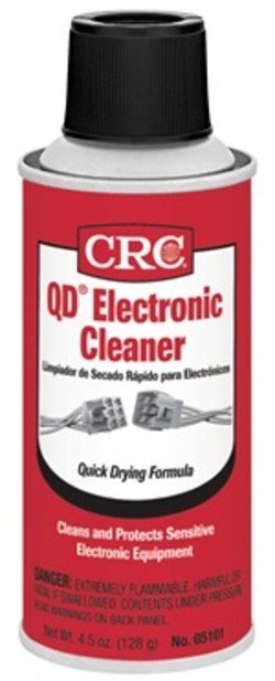

I do this all the time and have been doing so with all my cars. Here is what I do, whether it's the "right" way or not:
First buy this at your local automotive store:
http://www.crcindustries.com/auto/content/prod_detail.aspx?PN=05101&S=N
I then make sure my engine is cold and visually inspect all wires that I can. I spray it down with the CRC spray and take note of where the connections are.
I then spray any household cleaner, like 409 or whatever (I don't use a degreaser as it'll strip the grease off of where I need it, doesn't get it as clean but that's fine with me). I turn on the engine and then spray the cold engine with water from the hose. As the engine heats up the cold water isn't such a "shock" to it as that can cause the metal to go brittle.
I use a slow flow garden hose, wetting what I can after making sure I'm not getting the parts that shouldn't get wet, wet.
After I'm done, I let the engine run for 10 minutes to further dry. Then I turn off engine, wipe off access water, then spray liberally the CRC spray.
