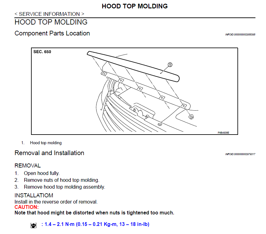

Just noticed today that above each nut that holds that chrome hood molding is slightly dented. :timebomb: Probably from the factory, they should of came up with a better idea or reinforce it so you cannot dent it by tightening it. Annoyed.
