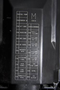

Is that possible? I installed one set and it worked one day, then shut down the next day.
I bought another set and still didn't work. So now I am thinking its the fuse box.
Could u'all tell me where it is? Thanks.
I would check fuse in the IPDM E/R in the engine bay behind the battery.

You dont need to. It slides right up just push on the tabs behind it. Theres wire slack behind it solely for that purpose. I did it on mine.
Awesome!! Thanks guys!!
Working on FX is easier because of the support of you guys!!
---------- Post added 09-10-2015 at 12:24 AM ---------- Previous post was 09-09-2015 at 04:07 PM ----------
Ok, so I went ahead and changed out the 10A fuse for the fog light(man! didn't that fuse box properly secured with multiple layers!!)
Turned on the switch...they were lit!!! for 2 min. Then both of them went "poof"
I figured I need to increase the resistance of the fuse since I am using 55w HID.
Dropped a 25A in and it has been ok for couple hours. Finger crossed. Thanks again guys.
