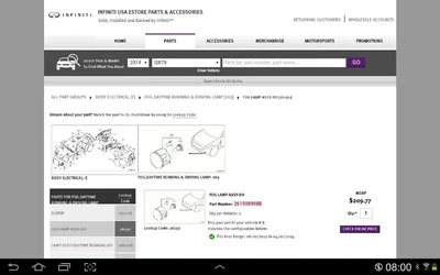

Screenshot_2016-05-15-08-00-31.webp Hi everyone from the land of Subaru & Audi! I have a cracked lens on one of the fog lamps on my QX70. Has anyone replaced this part (below) on their own? Looks like it's available OEM on eBay for $140.

Welcome! You Should be able to replace it by removing or pulling aside the wheelwell cover to access the clips & bolts that hold it in place

The fog lamp assembly is held on by a couple of screws/bolts and clips. You will need to pull back the wheel cover to get to the assembly.
