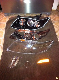

After opening the headlight assembly

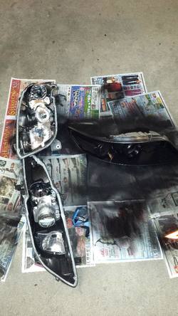

Spraying the assembly satin black

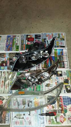

Stock Heads
Stock Lens

Satin black heads
TSX-R lens

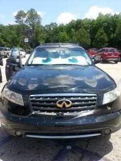

Same here, just like gold, painted mine satin black, masked the shrouds to leave the chrome accent, a fairly easy DIY but makes a big difference, and def do the lenses too if they are "beat up"
