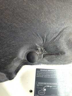

Just went outside to remove the STB and there are grooves dug into the padding on the underside of the hood. So it is touching after all. So frustrating.
