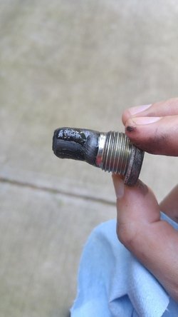

I changed my differential fluid for the first time at 60,000k. The magnet was nasty! This is what it looked like after a few wipes. I would highly suggest doing this every 30k. It's pretty easy to do it yourself also. Saved me $500 from the dealership.

Be sure to remove or losen the refill plug before removing the drain plug. Do it in this sequence, so that there is no chance of leaving you with an empty differential or transfer case because you can't not refill due to a stubborn refill plug.
Yes, that drain bolt magnet is nasty. I changed all the front and rear differential oil and transfer case oil about a month ago. I noticed the front differential magnet bolt was (a lot) dirtier than the rear; there was a thick layer of junk. That was really puzzling.
My front bolt was dirty and my rear bolt was clean.
This was my 3rd time doing so. I did them at 30,60,90k. With Mobil 75w-90.
The rear bolt/fluid was perfectly clean. Kinda felt like a waste to drain and fill. The front bolt was another story.
T case and atf were pretty average wear. Not super clean nor dirty/burnt.
