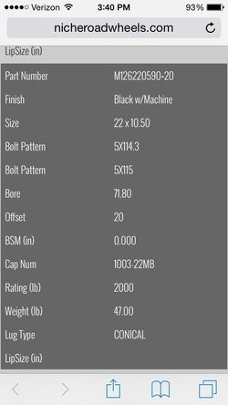

They're going to look good, but may rub depending on ride height and tire size. If stock height or on springs, no worries unless you get a wide tire. And the center cap should be fine. The offset is usually added on the backpad which pushes the wheel out so you'll have more clearance there. The other guy who has clearance issues at +45 so all things being equal, you'd have another inch of clearance there.
