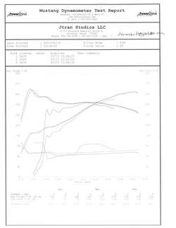

I'm an engineer so I have a hard time swallowing generalizations. It does do squat. In a measureable way. Dynos show that. Is it a big change? No. But it can be maximized with a tune - optimizing the AFRs for the particular intake setup on your car.
It's not just the MAF that controls fuel - the O2 sensor plays a large part as well - after the motor. It sees what the gasses are made of and makes corrections to get the balance of exhaust gasses optimal.
I did the baseline - here is the before (intake, plenum spacer, Stillen Cat-back) and the after with the UpRev tune. This is just one datapoint - the parts you use and the tuner's experience has a lot to do with what power increases you will see on your own FX.
