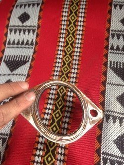

Well basically i tightened everything up and ended up threading one bolt by accident[emoji29] and there is still leaking. I figured the problem might be with the gaskets i took i pic of it once i removed it here it is 42e08735fb6a3ead173b115f4d4f0fdb.jpg
Id appreciate it if someone would let me know if this looks ok or does it need to be replaced? And is there a front and back side to the gasket? Or anyway i install it its ok?Anyway i know the problem isn't that big but i just dont like the fact that there is dripping even if it is for only a few minutes. And thanks in advance[emoji106]

Hmmm... the gasket looks fine to me. There isn't a right/wrong way to reinstall the gasket. It night help to seal better if you can tell which is front and reinstall it the same way. Are you doing this with the car up on a lift in the air or just jack stand on the ground? It might be just a matter of alignment of the pieces if you doing it on jack stand as there not much levage to push and align the pieces?

there is likely a small dent or crack letting air thru... try a new gasket

As porkandbeans said use a new gasket. They compress and when reused may not conform exactly as the flanges could be off just enough for a minuscule gap to be present.
Just get a new gasket. In the picture, you can see where it's leaking. Look at the black spot on the bottom.

So i thought id just finish this up, i ended up buying 3 gaskets and it turns out that the resonator gasket is different than the muffler gaskets, for the bolt i had the hardest time getting it off, i tried pretty much everything, finally after 3 hours i decided to just cut the it,anyway installed new gaskets and just to be safe i put some gasket maker silicon to make sure it didnt leak, and thankfully it didnt[emoji111]️
