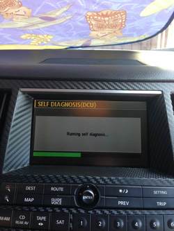

You can try this.
Turn on your ignition dont start the car.
Turn off your radio press/hold menuknob on radio and turn the volume knob several times 20-30x.You will see a vehicle diagnostic menu with error codes.maybe you can find what is wrong.
If you want to know what the code means you can search infinitihelp.com for these codes or enginecodes.com

I didn't know you could get diagnostic codes on the nav, will have to try that out.
