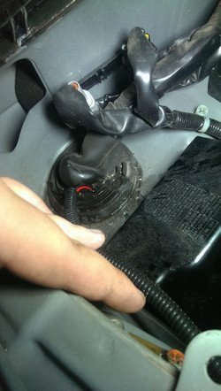

Today, I went straight to the rubber firewall and, well....
The dumbass (me) that poked that hole for the wires forgot to seal it.
I carefully dried the ECU with a heatgun, cleaned the connections, tried to start the car and bam, everything works without any issues.
Thanks to everyone for their input, especially Dracula.
