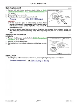

hello guys, back after a long absence...I was looking at removing the driving lights and replacing them...I purchased new lights fro APW and I can seem to get at the existing ones...does the whole bumper nose need to come off to do the swap?

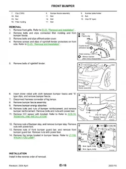

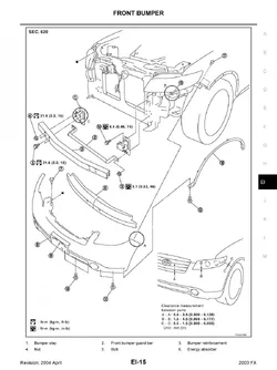

You have to remove the bumper cover to get to the mounting bolt that is mounted on top of the fog light housing. No need to completely remove the bumper cover. off the car. Just remove all the plastic push pins clips (#7 on diagram) around the grille, the two 10 mm bolts (#17 on diagram) where the bumper mate to the fender, and unclip the 3 clips (#15 on diagram) under the headlight housing so that the bumper cover can hang down and out enough to get to the mounting bolt.
