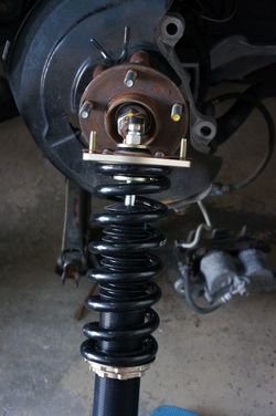

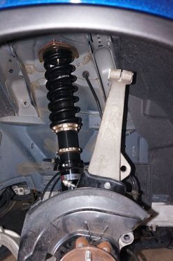

If you're replacing the stock suspension with coilovers, simply swap the coilovers in as most coilovers are already pre-assembled. Be sure to put the red paper gasket back onto the strut mount and put the strut assembly back into car.
