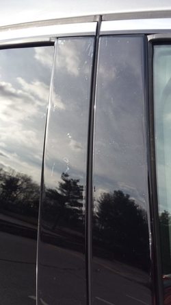

Looks like I have the same issue Veritas was talking about.. Any way to clean this up or do you think covering it with vinyl would be a better solution? Looks like someone sprayed something on it and it got on my pillars too :at-wits-end:

likely cleaning chemicals sprayed on without any water then not cleaned off in time so it etched the metal/plastic. You can try and clean it off but may need to recover. That is essentially a wear and tear item it would likely not be covered under warranty for a 2011 CPO. Doesn't hurt to ask.

Finally got around to using the Colonel Brassy yesterday, worked amazing on the chrome trim! Followed up with the mothers polish, it all came out great. Little nervous to try it on the B Pillars though, tried it on one spot and it took the shine right off, left it looking very dull. Used some polish over the area, and brought the shine back somewhat, maybe I just need to keep going over it..
You dont have to dilute it on anything. Just use it as it is & the colonel brassy is just for metal & aluminum & non shiny plastics or plastic thats all oxidized somehow. Dont use it on shiny plastics. You can use plastic polish from autozone. You know the one they use to polish headlamps to bring back the shine on the B pillars just make sure you use a soft towel.
