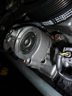

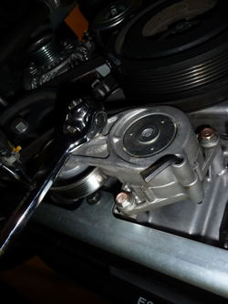

3. USE A 14MM WRENCH TO TURN THE PULLEY NUT ON THE TOP AUTOMATIC TENSIONER COUNTER-CLOCKWISE. (DO NOT TURN CLOCKWISE, IF YOU TURN CLOCKWISE YOU WILL LOOSEN THE PULLEY AND THE WHOLE AUTO TENSIONER ASSEMBLY WILL NEED TO BE REPLACED.) AS YOU TURN COUNTER-CLOCKWISE LINE UP THE HOLDING BOSS (TWO HOLES) AND INSERT A 6MM ALLEN WRENCH TO LOCK THE TENSIONER.

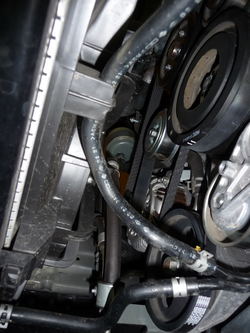

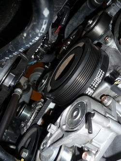

5. ON THE BOTTOM TENSIONER YOU WILL USE THE HEXAGONAL PROTRUSION PART WITH YOUR SOCKET TO TURN COUNTER-CLOCKWISE. AFTER LINING UP THE HOLDING BOSS INSERT YOUR OTHER ALLEN WRENCH.
6. REMOVE THE POWER STEERING BELT.
7. INSTALL YOUR NEW BELT, MAKING SURE ALL RIBS AND GROOVES ARE ALIGNED.
8. USING YOUR WRENCH ON THE HEXAGONAL PROTRUSION TURN IT SLIGHTLY COUNTER-CLOCKWISE AND REMOVE THE ALLEN WRENCH WE USED TO LOCK THE TENSIONER IN PLACE.
