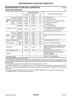

Im thinking of changing all the fluids in my fx. I was wondering how much of each fluid i need to buy, type and brand?
thinking of doing the following( please add if i forgot something)
-front differential
-rear differential (AROUND 1.7 QUARTS?) diy ///14007
-brake lines
-rad fluid
-transmission
-oil + filter ( 5 litres?)
