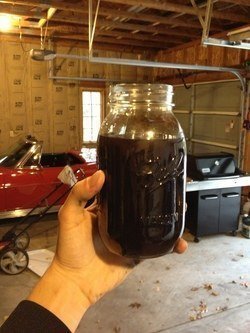

A few things that I noted: The rear took about 1.8 qts and the front took about .8. I pulled a bit of sludge off the magnet on both, but it seemed normal from what I've encountered in the past. I did re-use the old washers on all 4 plugs. The fluid came out somewhat dark, but not as bad as I thought it might be. Replaced with Mobile 1 75w-90 Synthetic. Next up is transfer case and trans!
