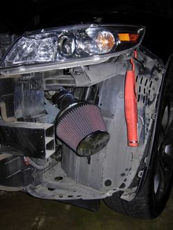

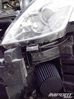

velocity stack helps straighten the airflow which allows the ecu to have a more accurate reading of actual air ingested to the engine, meaning a more accurate matching of fuel, so then yeah, you benefit from the higher air flow... the whole point of this is that JUST increasing airflow itself is not enough to make more power if the ecu cannot accurately measure the airflow anymore... the mass air flow meter can only measure the surface area of a small fraction of its total opening, & this tiny sample needs to be representative of the total airflow for the reading to be of use so it assumes an even flow throughout the whole maf opening, law of averages... anything that disturbs that, say forcing extra air on the sides where it will not be measured or forcing extra flow at the actual small sample area making the ecu think there is more flow than actual... either one of those situations will skew the ecu's attempt at precise metering of fuel:air & negate any otherwise potential gains... a custom tune can somewhat compensate for this & many tuners will think that they are just correcting a deficiency in factory metering, where in reality there just compensating for a skewed MAF reading to begin with... the truth is that with a proper MAF setup, the ecu itself "should" be able to compensate for the addl air flow & match fuel to it... many times a custom tune is really done to correct errors like this, sometimes without the tuner even being fully aware of why he needs to alter the maps as he does... his whole target though is strictly AFR, so in essence he can correct this situation, but it may not have even been a situation had this problem not been caused to begin with...
