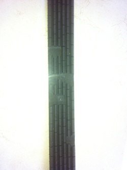

Something came up, I suddenly decided to check on my drive belts and they looked something like this:
So I had them replaced with goodyear ones, and here is what happened:
1) bump steer problem reduced by 50%
2) there was some looseness in the steering (not the steering wheel) which I could feel more when off road ... 100% gone
3) there was a grinding noise under the hood that usually starts 5 minutes after the AC is on .... 100% Goneeeeeeeeeeee
4) I could feel a lot better grin of the road, the car feels more steady and firm
Now I have only changed the belts, how bad having bad belts can be?

Well, I know the consequences when they break, what I am trying to figure out is the effect of them being that bad on the car performance like that, I been thinking that every time a crushed zone comes around any of the pulleys it causes it to maybe shimmy or slip a little, which consequently cause all that AC noise, and inconsistent input torque to the steering pump that causes maybe steering looseness, and such.
