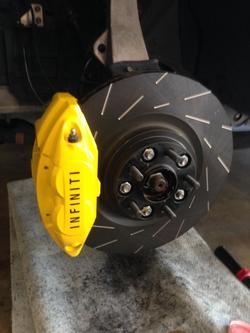

I recently had my calipers rebuilt and installed new pads and rotors. Does anyone know if you need to have the ignition in the "ON" (Not engine running) position when bleeding? I have bled the crap out of these things and still have a soft pedal. I am thinking ignition now because of the ABS but am not sure. if I pump the pedal three or four times it is very stiff but if not, the pedal is very soft. Brakes are still very strong but I dont like the soft pedal and am a bit miffed? Thanks in advance.

Oh yeah, install was correct, I did it myself ;) Bleeders up for sure! Thanks again :good:
